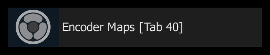

Encoder Maps [Tab 40]
Custom encoder maps allow you to create and store unique parameter layouts for your fixtures. A custom map can be assigned as a console-wide default, or applied more selectively to specific fixtures, groups of channels, or console users.
Encoder Maps can be opened in a standalone tab from the Workspace Layout Menu or by using [Tab] & [4][0].
